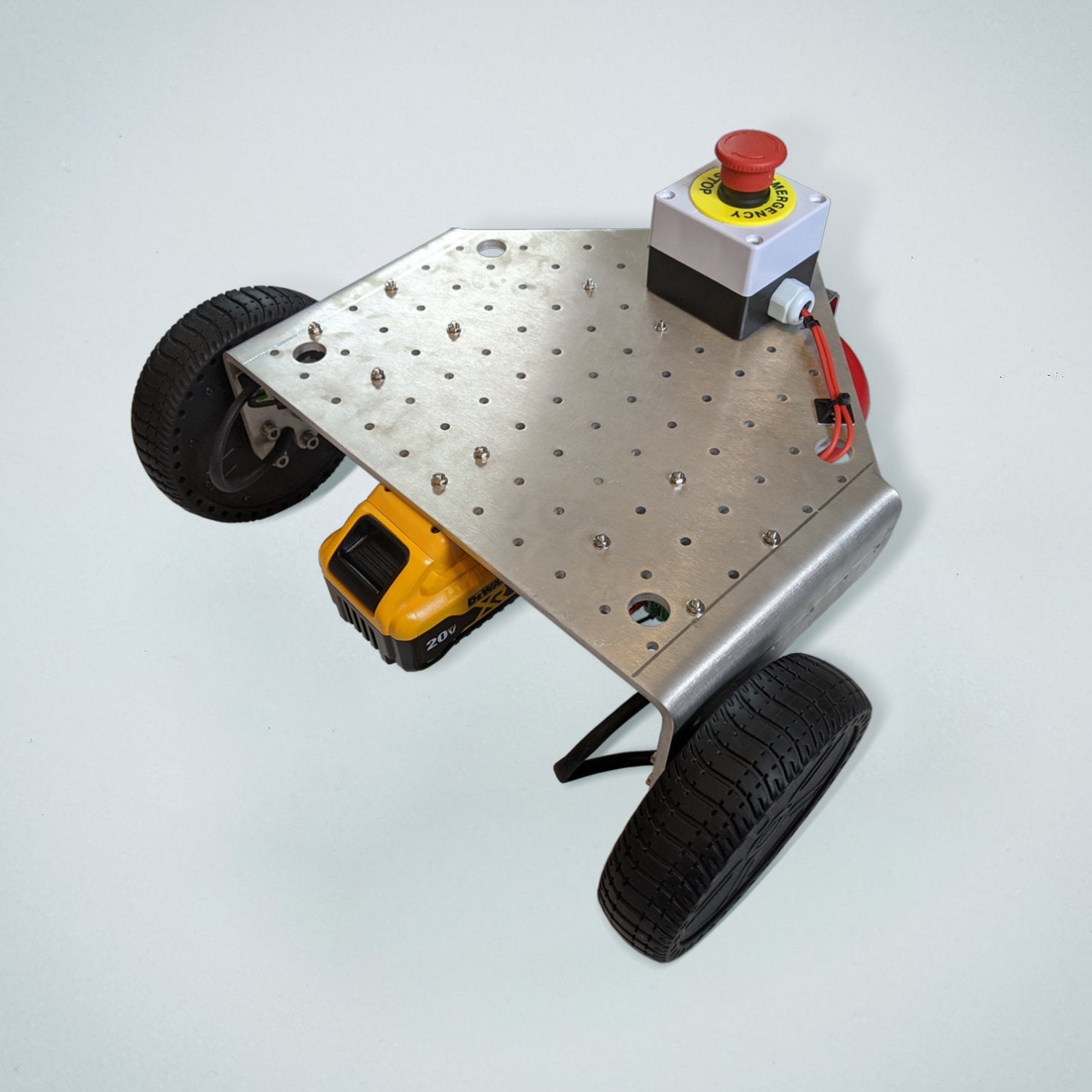

A high-performance modular robot chassis, featuring the ODrive S1 and ODrive Botwheels. Powerful and flexible, the Botwheel Explorer is a capable foundation for many robotics applications.
Note - The Botwheel Explorer kit requires assembly, as well as additional components and tools to complete.
  • Included in full kit: dual ODrive S1 + ODrive Botwheel
  • Easy setup in the ODrive GUI, and demo software for remote control
  • Aluminum chassis for ruggedness and reliability
  • A 30x30mm grid M5 (untapped) hole pattern for mounting additional sensors and actuators
  • 100kg load capacity

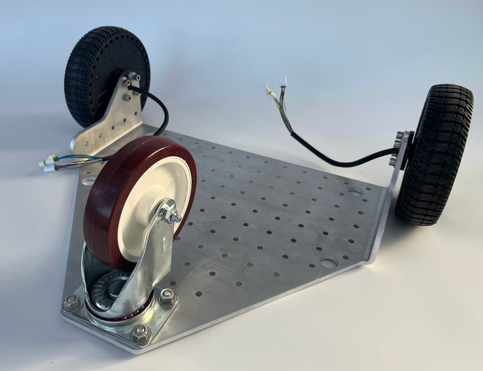

We have updated the Botwheel Explorer to RevB, which is larger and includes an improved caster. Please contact us at info@odriverobotics.com if you would like to order RevA.

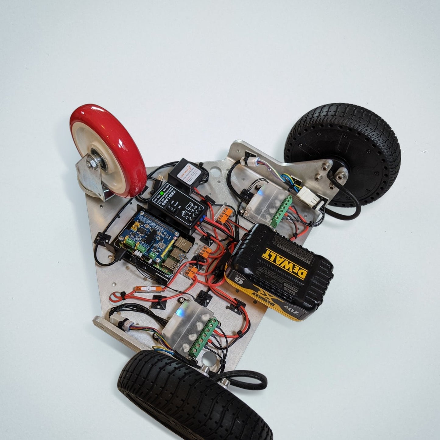

What’s in the full kit:
Additionally needed:
