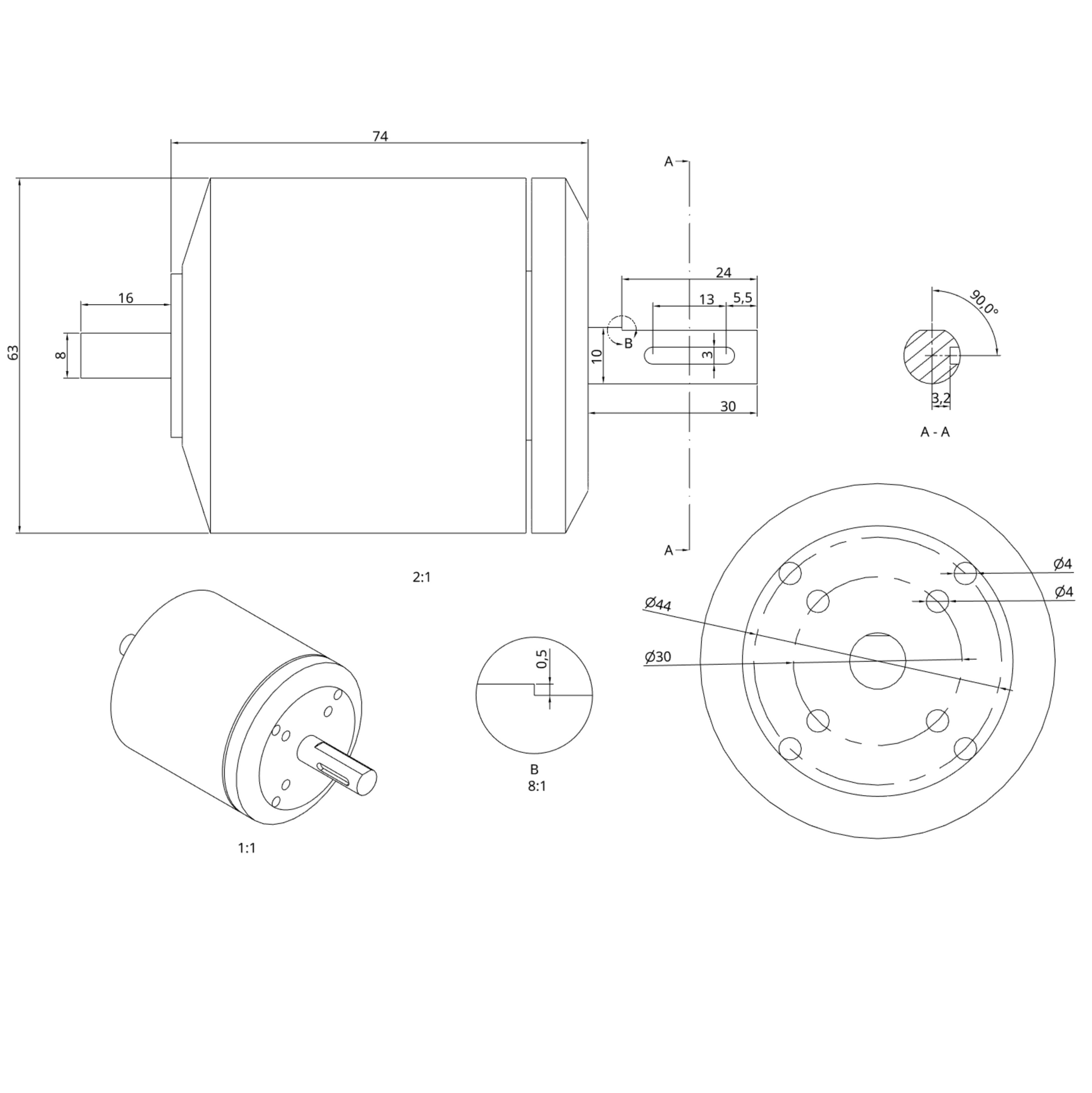

- 10mm primary shaft with flat and keyseat, see drawing.
