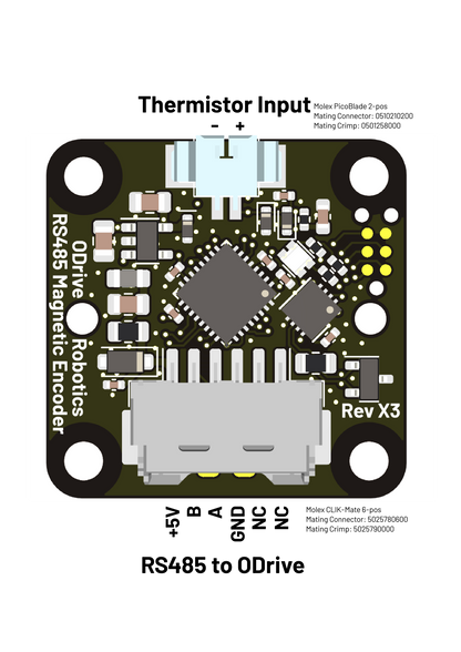

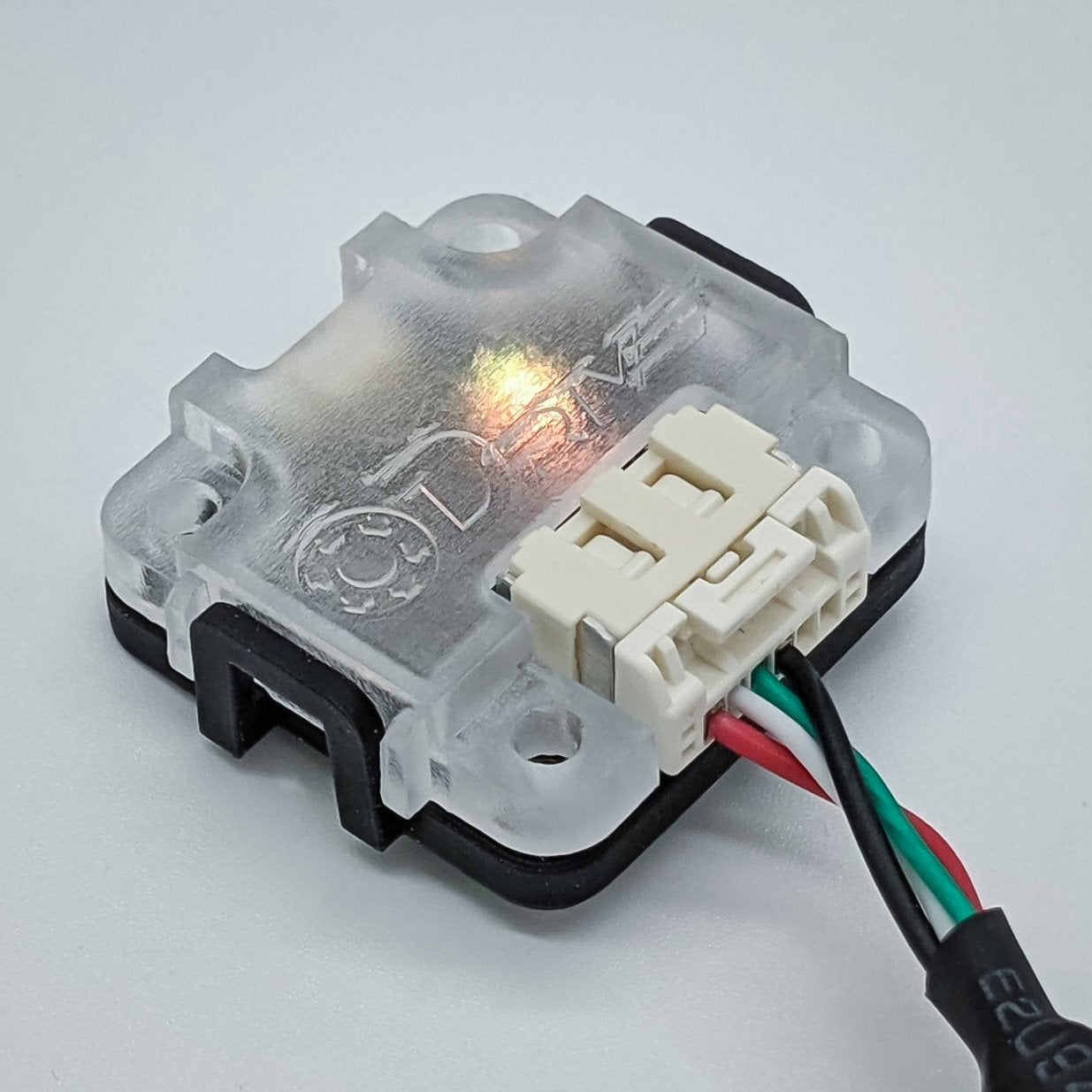

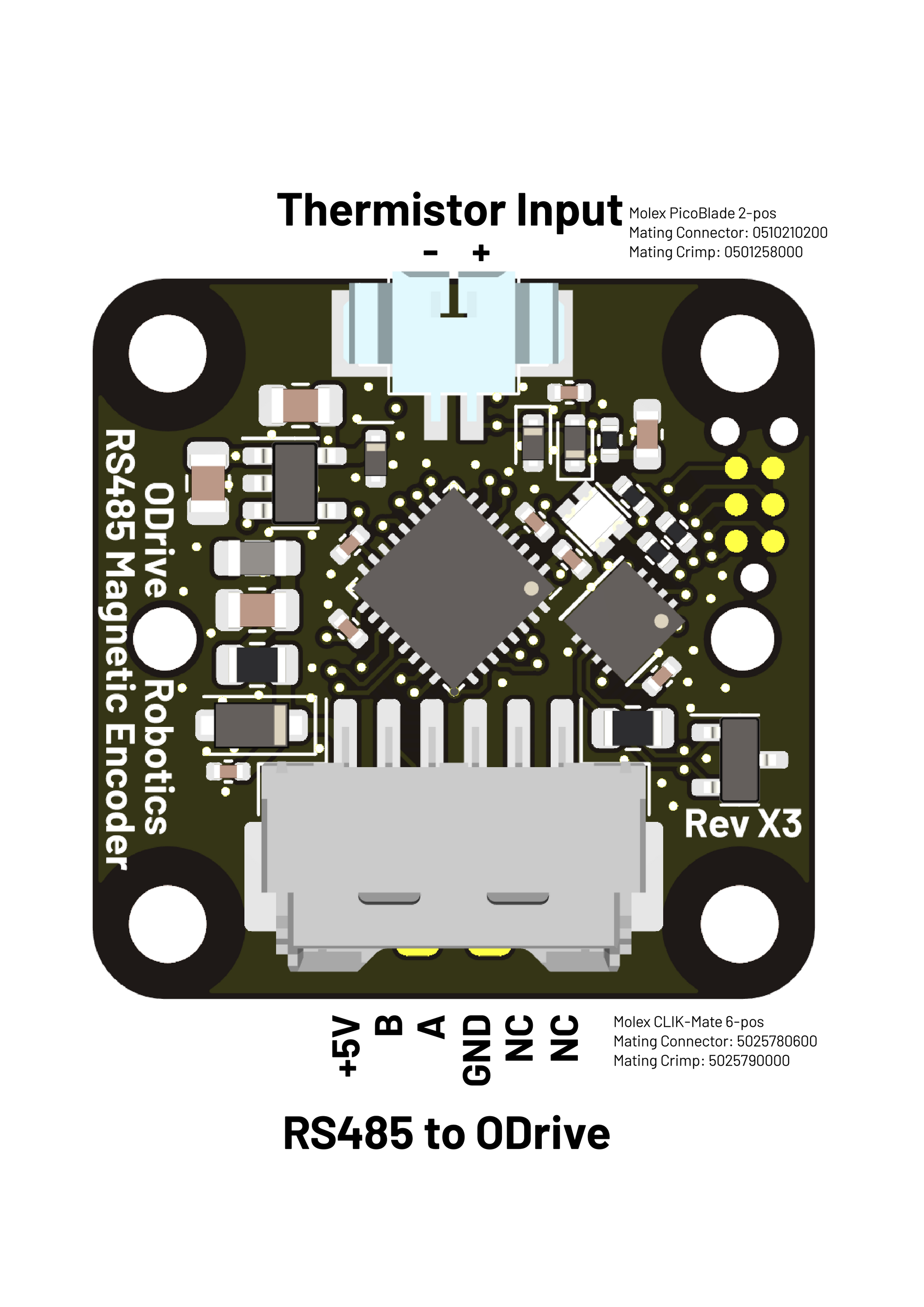

High performance, non-contact on-axis magnetic encoder with robust RS485 differential signals to the ODrive.

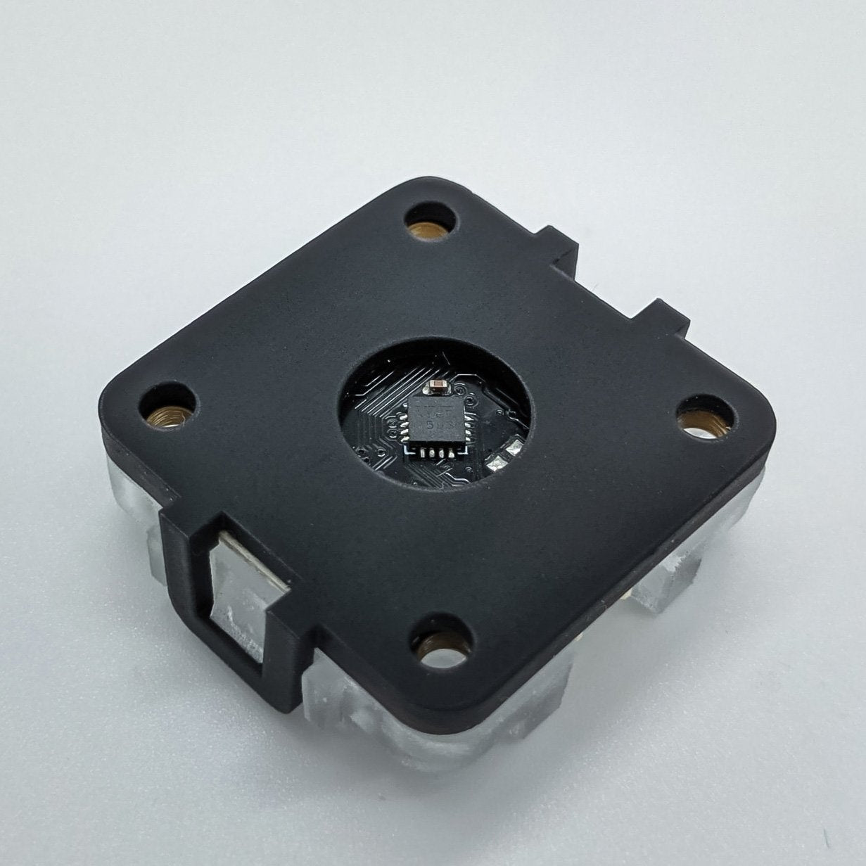

  • 12-bit MA702 magnetic encoder (same as ODrive Pro and S1)
  • Recommended for use with ODrive encoder magnet (included). Recommended distance 1mm from bottom of case.
  • Maximum Speed: 60,000 RPM
  • RS485 interface for robustness and reliability, even with long cables in high-EMI environments
  • Seamless integration with ODrive Pro and S1 (connect with the wire harness for Pro or S1)
  • Included case for protection and ease of mounting
  • 10k thermistor input, allowing both motor position and temperature sensing over a single cable (requires ODrive firmware update, coming soon)
  • Onboard indicator LED to help encoder positioning for optimal magnetic field strength
  • Custom form factors are available - contact us
Datasheet - CAD
Cables can be purchased separately:
SKU: ENC-OA1
1 - $ 39.00
10 - $ 38.00
40 - $ 36.00
100 - $ 34.00

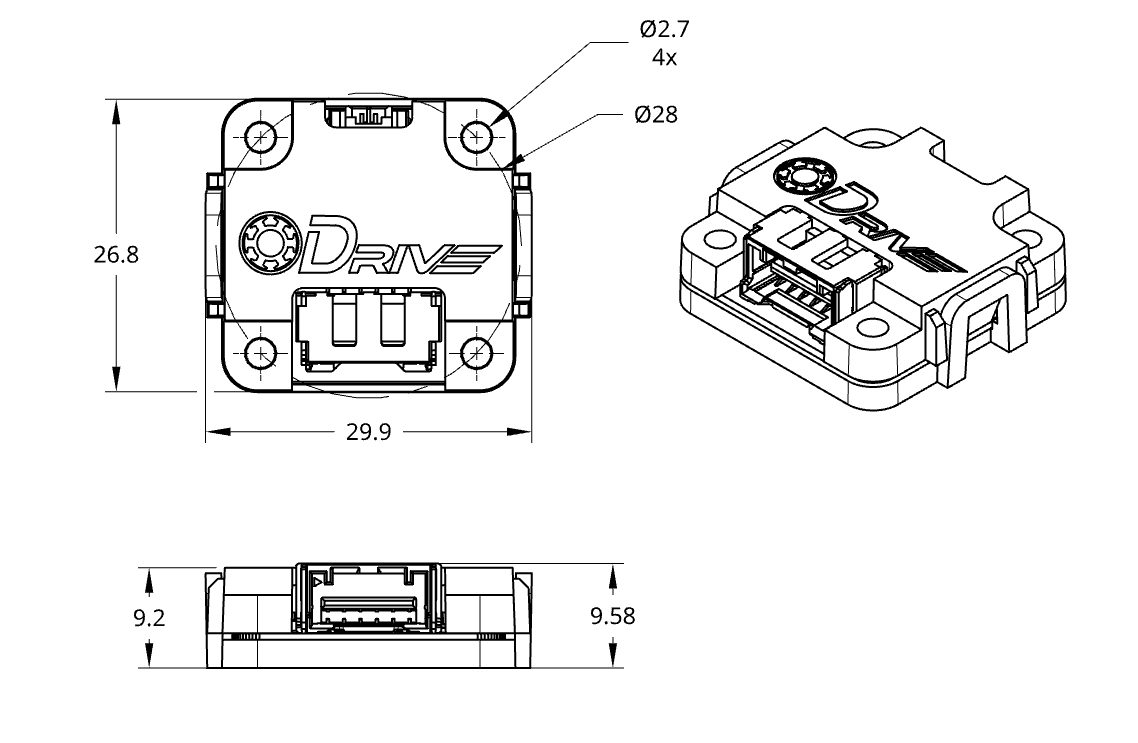

Mounting details:
  • 4x M2.5 (clearance) on a 28mm bolt circle
Connection details:

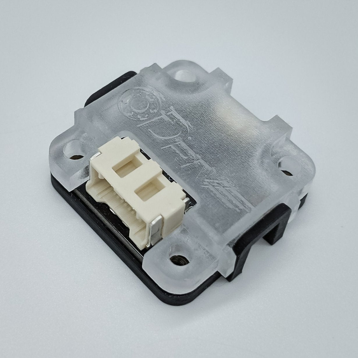

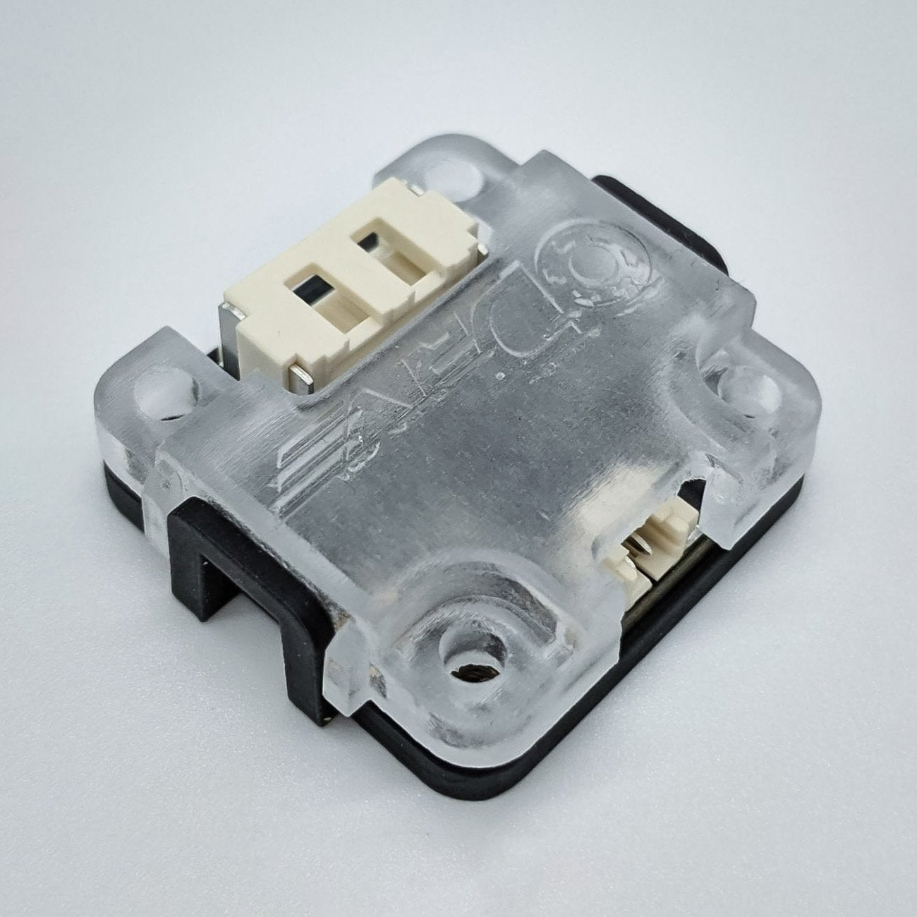

  • Thermistor connector is 2-pos Molex PicoBlade
  • ODrive RS485 connector is 6-pos Molex CLIK-Mate
